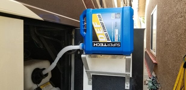

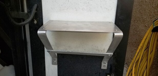

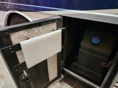

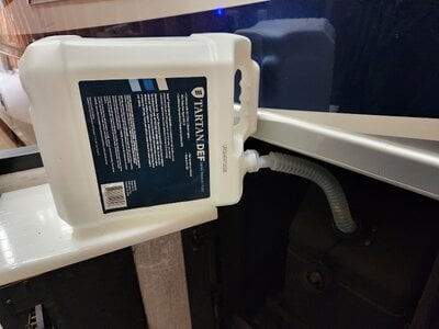

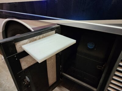

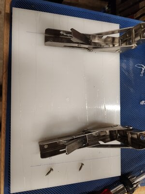

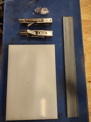

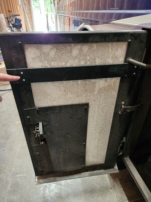

I almost always use truck stop DEF but with being in storage more than I care to be and with my last trip out after a long time in storage I bought boxed DEF. It's not the most joyous or speedy experience to hold boxed DEF while it slowly fills. What would help is a super complex, highly engineered, L shape angle bracket mounted to the DEF door or a swiveled option that folds out mounted to the inner frame that you can rest the DEF box on that is properly, with PhD engineering approval, angled down in the pour position.
A simple mod that can make boxed DEF pouring easier.
Sounds like you could benefit from a little gym time. :D
I use a razor knife to make a breather in the top/back of handle. Drains much faster
