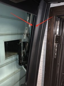

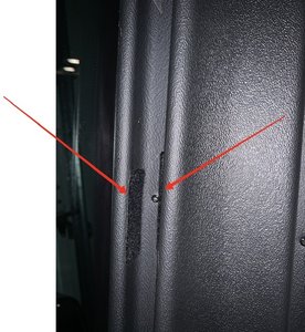

Yes I have, take the soft side of Velcro and cut 4 5 inch strips, bring your shades down to driving position and center the 4 strips in the front and back side of the shades within the tract.
Are you placing the strip inside the track?
Yes so it faces the shades on both sides, felt would also work.
Here you go, note that my strips are not 5 inches, I recommend longer so you have more range to open or close the shades with the lower rod of the shades between the Velcro
