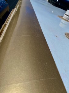

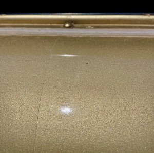

I was given some advice that I would like to pass along. I was told to look carefully above the awning fabric mounting track on the passenger side. This is the sidewall mounted awning, not roof mounted. I was told to look for the presence of cracks above each mounting screw. I am told that some owners are finding cracks at every screw and some as long as 4 to 5 inches.
I took a look and to my surprise, I too found cracks. I took photos and sent them to my Ventana service advisor. I am now scheduled in September to take the coach to Nappanee for an aluminum overlay application. The description was to install an aluminum sheet under the awning fabric mounting strip. Then, the sheet is rolled up to the roof and fastened. Then the sheet is color match painted. I am told it cannot be seen from the ground. They need the coach for 5 days.
You’ll need to zoom in on the photo to see the crack.
