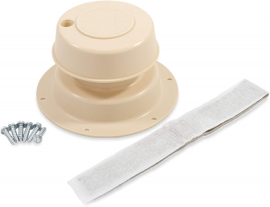

Has anyone replaced the vent caps for gray or black tanks on the roof. Looks like it is two pieces held together with a screw but not sure of replacement options. If I can just replace the top that would be a lot easier. Ours must have gotten brittle and hit by something dropping because there is a chunk out of it.
Thanks in advance.
I replaced mine on our 2017 with this type, easy install and didn’t require a lot of work.
Thanks! I saw those on Amazon but wasn't sure how easy it was to swap out the cap.
Mine was totally missing, just the pipe was there.
I did replace mine this year. One was missing and the other one had the rigidity of a soda cracker. Replaced them with
