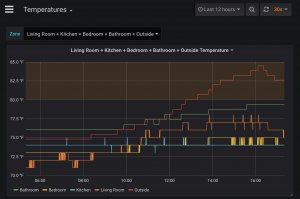

Here’s a snapshot of the “Home” screen, which I customized based on what I have found to be important to me.
To give you a little but of an overview, the top row of buttons show the temperatures of each zone within the coach. I have color coded the temperature to show if it’s out of what I considered the normal range (to be configurable later). I have also set the background color to show me if the HVAC system is currently active for the zone. This provides me with a quick status of the temperatures and info on which HVAC units are currently running to cool or heat the coach. Clicking on the temperature brings up a graph that provides historical temperature information.
The next section provides information on the water pump/tanks. I can click on the water pump icon button and it will toggle the pump on and off. This interaction is immediate and doesn’t require any email or FTP protocols. On the “water” page, I can also control the Oasis burners/AC, and open/close my waste tanks utilizing a separately developed capability.
The next section provides me with battery information. Voltages for both sets of batteries and whether the charge bridge is current active. Then I have the current charging state and how much current is being output by the charger. This information updates several times a second as I am reading data directly off of the RV-C network and the application updates at the same rate as the data is available.
We then have AC power information and then the lock status (with the ability to lock and unlock the entrance door and compartments). Also the ability to turn the burner on/off. The light buttons turn on/off all the lights just as you would when pressing the two KIB panel buttons simultaneously.
In addition to displaying all this data; allowing the user to turn things on and off; and graphing the historical data; I have integrated notifications (application based notifications and SMS) and automations.
My goal was to be keep informed when “things” happen. Right now I receive notifications when the doors are [un]locked, the power source changes, the generator starts, the engine starts, batteries are low, and many more. I find this to be useful for when my coach is in the shop, so that I know when they are actually working on it, as well when I’m away from the campground and the coach looses power. There are also many other use cases.
I have setup automations such when the coach starts to move, the water pump will automatically turn off. I even have an automation to turn off the pesky KIB panel backlight at night time and then turn the back on the morning. (I actually have the system setup to dim them at late evening, and then turn them completely off at bedtime).
