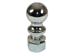

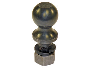

Here are two different 2 5\16 balls. They both look the same. The one on the right is a normal Reese brand $12 get it from the auto parts store ball. It is only rated to carry a total GTW (gross trailer weight) of 5,000 lbs. That's less than the F150 many RVers tow behind their rigs.
The ball to the left is also 2 5\16 but is rated to carry 30,000 lbs. You wont find that ball at your local pep boys.
The same ratings exist with hitch mounts. Most mounts sold at the auto parts store is a 5000 lb GTW. You will pay a premium to get a 30,000 lb hitch mount. Just been my observations over the years

Do you have a source for or link to the 30K-pound ball, Dave.

Thanks, Dave. Good information.
