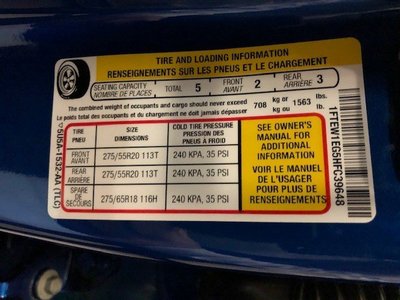

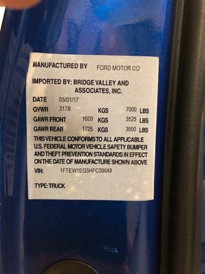

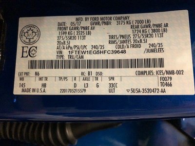

I'm currently in the process of purchasing our first travel trailer since I'm getting ready to retire and I have a F150 Lariat with the HVY duty tow package which is rated to 10,000 lbs. We are looking at the 2021 Forest River Hyper Lyte 26BHHL which dry weight is 6680. Does anyone have any experience with these models or manufacturer? We really like the floor plan and are trying to stay in the budget of 25,000-28,000.. Please give me your thoughts and recommendations... I've read the reviews on almost all manufacturers and they all seam to have some sort of issues here and there.. Any advise would truly be appreciated.. Thanks
