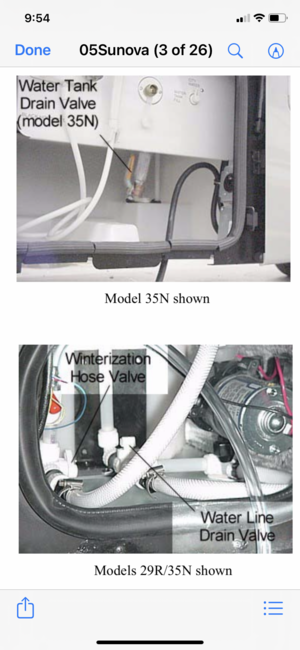

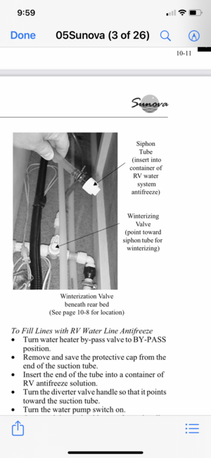

So I am new to the RV took it out for the first time, not sure if I have everything turned the correct position to unwinterize. I did find a bypass line for the hot water tank so that is good, but this drain line I’m not sure the correct position of this nozzle? The syphon hose one it’s self-explanatory but I’m not sure about the other one which I think drains the tank?
Would either of these affect the water pressure in the sink?
