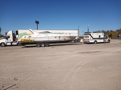

Hello, new to the Forum but RVing for 30 years. I own a good sized custom hauler motorhome, International 4300. I pull my 45ft boat that is 12ft wide and 12 tons with a wideload permit between Wisconsin & Florida, I have done the trip a dozen times without any issues .
