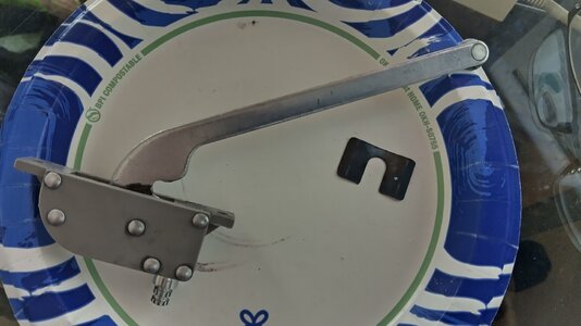

A few of my roof vents open while I am driving. I pretty sure it is the screw mechanism is stripped somewhat as I can snug them down but if I keep tightening, it will slip lose and then to snug again. I looked up replacement parts but it depends on the model of the vent. I can not find any labels in the vents themselves or documentation on the coachman site. Anyone know the model used? Hengs, ventline - etc.?
thanks... tim
Update: I attached a pic. Thinking this may be the part from amazon: HENG'S INDUSTRIES JRP1000B Arm Gear

Our 14 Forester used Hengs - at least the fan motor I had to change out.
Depending on the year my “guess” would be Heng since Coachman and Forester were essentially the same.
Thanks Dennis - going to see if our extended coverage insurance will cover the replacement. But think they are Hengs as well based on the pics and dimensions.
