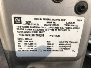

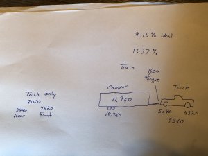

Hello,
I think the image loaded ok. On the left was weighing my truck unhooked, and on the right, are the weights I got on the scale.. I see i'm over 160lbs or so for my total truck weight.. not sure what to do about that?
Also, does the tongue weight count towards my total truck weight ? the trailer is only allowed to weigh 12,000 lbs ..
Input ? thoughts ? Also, I see I "lost" 300 lbs on my front axle when I am loaded, is that ok, normal, expected, needs to be more ?
It is a 2021 Grand Design Momentum 28G and a 2006 Silverado 3/4ton diesel.
