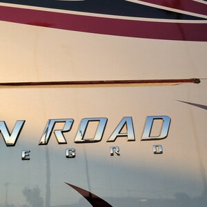

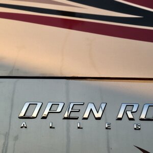

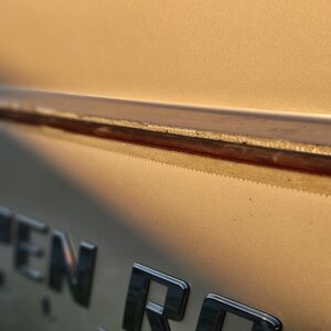

First I need to know how to turn off the bathroom light power without shutting off all power and second what is the rubber like antennae on the rear section of the RV about halfway up? Did not know it existed till it was blown off in a wind storm. Having hard time getting answers from Tiffin via email.
A photo would help as I can't figure out what you're talking about.
That, my friend is part of your rear brake light system. Have someone go step on the brake pedal and watch it light up. I had the same problem on my 2019, and I could not figure out what it was, with wires going in. I just cleaned doff the piece, put double sided tape on it and stuck it back on. I also put some RTV in the open hole where the wires come out of the rear cap.
