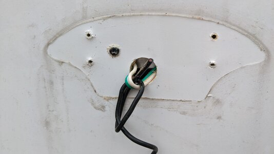

My 2022 RB253 was "prewired" as well. Turns out the Furion power pigtail was just tied to the running light wire. Not actually spliced, just tied.
See attached pic.

Yes that's how my 2023 I just bought was and I brought it back to them. They use it as a sales pitch that it's prewired for backup camera well that's what I was told and thats what I expect it to be... Now what I'm not sure is shouldn't it be hooked to a constant hot wire and not just when running lights are on.
