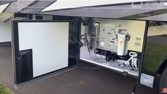

The basement door hinges are sturdy, I will say that but the other day I opened one of the right-side doors and Bang!, when it opened to the stop the door fell three inches! It turns out the door is held vertically in place on the hinge by a couple of very small, Too Fricking small, snap rings. There are two aluminum bushings that serve as hinge bearings which is a good plan indeed. The issue is that the weight of the door is supported by two little 5/8 inch ID X 1/16 inch thick outside snap rings, The snap rings popped out of their respective groves so the door just dropped and was caught by a cotter pin at the bottom end of the hinge bracket rod. See attached Pic.
I had to buy a snap ring plier set that was small enough to work, lift the door back into place and re install the cheesy little snap rings on Friday before the trip we took up to Alexander Valley wine country for the weekend. I thought maybe only either the top or bottom snap ring may have been engaged during assembly and rigging so it finally failed.
I made certain both were as secure as designed. This morning when I opened the door to load up to go home, BANG! The door dropped again!! Luckily I added my pliers to my tool kit that I carry in the coach.
I will be calling Newmar to see if there is an improved hinge retaining mechanism. If not, I will machine new hinge bushings that will have a sheer and jam nut in place of the crappy snap ring. I will post my fix and who knows? I may produce them and sell as an after market fix.
I noticed also that another one of my fender skirts was flopping around when I got home. The shitty cheap self tapping screws that the assemblers used backed out and fell off. I will now be replacing all of that hardware with proper nuts and bolts with locking nuts.
