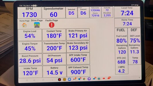

Thinking about becoming a BlueFire user for a variety of reasons, but primarily because I want to monitor exhaust gas temp (EGT) at the manifold. However I can’t determine whether or not the BF exhaust temp gauge displays manifold temp (like a pyrometer) or if it shows exhaust temp farther down stream (turbo outlet temp, DPF/SCR etc), and if it does whether or not the Cummins ECU tracks this info so it can be displayed by BlueFire?
So that’s my question - in a nutshell, can you use BlueFire to measure EGT like a pyrometer? This would greatly simplify the process of monitoring an important parameter. I’ll continue to research this, and I have an email in to BF (no response yet) but I thou*t someone here might know.
