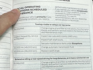

Interesting response for Ford Dealer, but not unexpected. Lifetime fluid will not service. VW said the same thing and they were correct the Life of the Transmission was expected to last 80-100k per documents uncovered by some enterprising journalist.
I changed the VW fluid about every 50k and transmission was working fine when sold teh vehicle with 200K on the clock.
Back to my point, recently purchased a 2018 Ford Flex with 35k on it. Plan on flat towing vehicle.
As is my practice with used vehicle purchases, I plan on changing all fluid, brake, coolant, oil/filter, and potentially transmission. This just to have a base line. Ford dealership will do all but refused the transmission fluid change. They said that they have had too many issues with fluid change in a transmission. From their perspective I understand the potential risk.
Why use a dealership, all data makes it to CarFax history and FOMOCO fluids other than motor oil are fine. I happen to prefer Pennzoil Ultimate 5w-20 and WIX filters. I am sure FOMOCO blend would suffice but for the few dollars more it makes me happy
Thoughts on changing transmission fluid?? Waste of money or money well spent??
