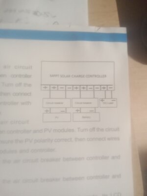

The wire terminals are for #10 wire and two ports are supplied. Follow the guidelines in the manual, or be sure to use larger wire for higher efficiency.
There are cute diagrams like this one for your amusement and understanding.
The load terminals are there to control things like relays, so you can control the timing of specific loads. Most leave those terminals unused, and that is my case.
