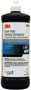

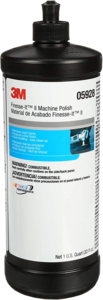

In my Newmar Ventana Class A Motorhome it came with corian counter tops. The finish provided on the corian was budget level polishing therefore not glossy. Maybe the intended style but I have granite in my S&B and saw a YouTube video on how to polish corian as well as how to fix scratches. While it was a messy process it was a simple process but does take some time. Essentially you take 3M Rubbing Compound with a polishing tool, I used a Dewalt variable speed polisher and apply the compound, mist with water and polish. When done then switch to 3M Polishing compound and voila, you have an amazing looking result. Be sure to use blue painters tape and drop cloths as well as hanging plastic barriers to prevent the spray from going where you don't want it to go.
