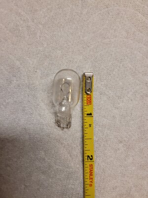

What lights your replacing? You have pics, numbers off the old lights?In order to cut down on power use, I'd like to use LEDs in my 2007 camper instead of the existing lights. I have not been able to find any LEDs that work. ANy tips would be greatly appreciated. Thanks!
Not house-type LEDs, but the small bulbs, about 1in long, that are used in the lighting units on the ceiling.Assuming you want house lights
Here's a picture of one of the bulbs. I'll take a picture of the socket/fixture next time I'm out there. It sounds like some kind of conversion kit would work, if I can find it.What lights your replacing? You have pics, numbers off the old lights?
Lookup T10 led bulbs. AmazonHere's a picture of one of the bulbs. I'll take a picture of the socket/fixture next time I'm out there. It sounds like some kind of conversion kit would work, if I can find it.
And use the lights that have DC to DC converters. They don't dim as the battery looses charge.Lookup T10 led bulbs. Amazon
Search T5, T10 or 921 LED 12v lights on Amazon and you'll find what you want. No need to change the light fixtures, these are a direct fit replacementHere's a picture of one of the bulbs. I'll take a picture of the socket/fixture next time I'm out there. It sounds like some kind of conversion kit would work, if I can find it.
