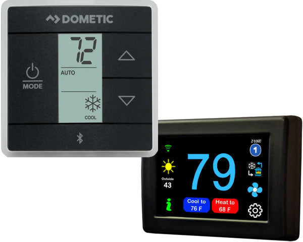

Not sure what type of thermostat your trailer has, I updated the generic Dometic to the Microair, and that seems to control temperature much better, the generic one sucked and did not really have any control other than on and off.

Thanks for the feedback. I do have the Microair. Haven’t installed it yet. I’ve been trying to balance out electricity and propane, but what a pain it has been using a 1500w space heater. It either has to be on the same circuit as my dehumidifier or Keurig Mini. If I turn one of those on without killing the space heater first, pop goes the circuit breaker. Somehow I had 2 air conditioners, a fan, and dehumidifier running simultaneously during the summer though. This sure takes some getting used to.
