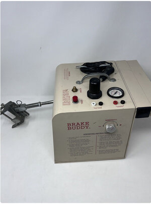

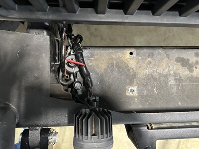

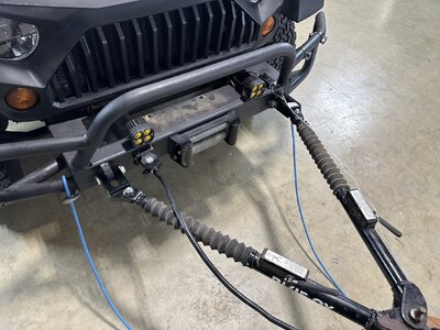

I went out on Craigslist and Facebook Market Place to see what I could find. Taking my time I eventually found a Blue Ox Alpha tow bar In good shape. I bought it, inspected it, cleaned and lubed it. Then went online and got a Black Friday deal for tow bar adapters to fit my front bumper. I had some trailer wiring laying around and wired the Jeeps rear lights for towing. Then made a harness to go between the Jeep and RV. Purchased a new breakaway switch from Amazon using points so no cost. Found a Break Buddy online, tested it and bought it and ran power and breakaway wires to it. Also bought a manual battery shutoff switch from Amazon at no charge (points). I believe I’m ready to go.

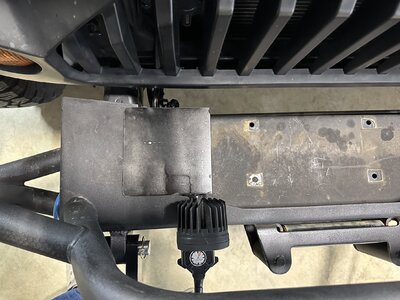

I also made a metal cover to go over the battery switch.

Blue Ox Towbar = $150
Towbar Adapters = $65

Break Buddy. = $75
Total: =$325
