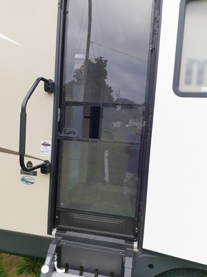

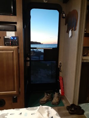

Storm door I made for our 2020 25FBLS. using 2mm plexiglass and 80lb velcro.
works great when having cooler or warmer temps so you have the main door open and still run your A/C or heat with a view.

Nice job!
