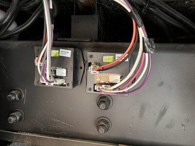

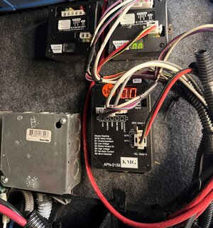

If your door side slide controllers are the same model and are next to each other, you can rule out the controller by unplugging both and plugging the bedroom controller plugs into the forward slide controller to see if it will bring the bedroom slide in. The door side slides on a 3709 are similar in size so they probably ise the same controller. I had a bad controller on my 2016 and Newmar replaced it with an “upgraded” model (Klauber KMG 1209).
These are my door-side controllers, both the same model and right next to each other so you can see that plugging the bedroom slide plugs into the forward controller for testing would be simple. They are both LMC30 Revision B controllers, likely the same as yours.
There were a lot of controller problems for 2016-2018. The 2016 and 17 problems were often solved by simply adjusting the amperage on the controller upwards. The replacement for my bad controller was a KMG 1209 - completely different unit but the plugs were identical so replacement was easy.

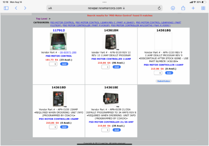

Is this a good slide controller replacement?
oks like it has the same female plugs.
I'd monitor it. Electronics do not like to be on for years as our motorhome's run electronics. A power cycle may have fixed it.
I agree with Niel - now that its working again it may continue to work for years. And also I agree that it would be smart to inspect the mechanism, check the mounting bolts, and verify the manual-retract method. It wouldn’t hurt to have a spare controller though. I think the cost for the replacement controller was around $100 from Newmar but that was a couple years ago. Probably 50% more now.

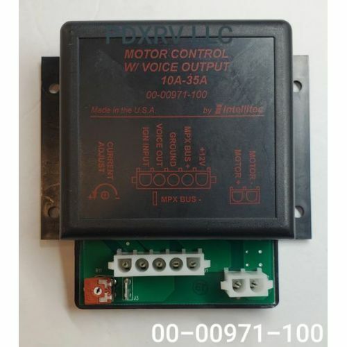

Personally I wouldn’t experiment with other third party controllers such as the Intellitec unit from Integrity RV parts without some reliable reviews unless its also the one Newmar is currently using. That said, it may be a better unit but some research would be in order.
Here are a couple of the Intellitec units “Integrity” sells for $187 on ebay for $60 less and free shipping:
And this is the unit on the Intellitec website:

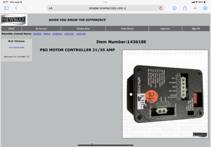

The KMG controller that Newmar sold me as a replacement for the failing LMC unit is from the same company (Klauber Machine and Gear) that makes the slide drive unit (gear motor).
Edit: Newmar now sells the KMG controller I bought for $99 in 2021 for $215. Everyone is on the inflation bandwagon these days…:mad:. A little research also found that Newmar used to use the Intellitec unit and they have discontinued that practice using the LMC controller for a few years and now the KMG unit. I also found in a brief search that people had issues with the Intellitec units 8-10 years ago.
