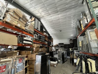

Im at National RV Refrigeration. Its an Amish shop and they do good work, have great customer service, but they are dealing with Dometic, Norcold, and other problematic products. But if you ever need an RV refrigerator this is the place. Lots of inventory and better proces than anywhere else. They can also fix almost any older RV refrigeration equipment. They are repairing a basement air unit on an older class A right now. They hope to have another new unit on my roof in the next couple hours.
Thanks, never thought of them for A/C - makes sense.
Well I was back on the road by 2:30 this afternoon which isnt bad considering they had to trouble-shoot the unit, then convince Dometic it was bad (probably over-charged from the factory), and still service all the other customers with appointments today. We are now just chillin (literally) in a somewhat large and busy, but nonetheless quiet and restful enough park in Shipshewana (Eby’s Pines) enjoying things operating as they should.
