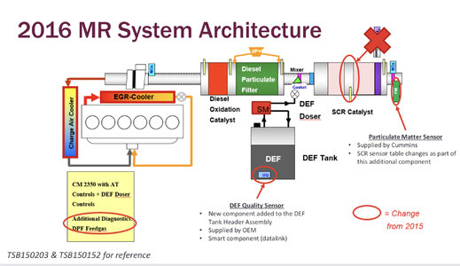

I had the same experience with Cat 3208 powered fire engines early in my career. They basically had to be at full throttle to get them to move. I like your descriptions of your findings. Depending on driving conditions and habits, it’s possible to never need a parked or forced regen. But note that soot is managed in the DPF, and DEF is used in the SCR to convert NOX to nitrogen and water vapor after the DPF. So two separate functions.
This is a nice diagram of the system: IMG_2847.jpeg
….from this document: https://www.apta.com/wp-content/uploads/APTA_Presentation-Diesel-Aftertreatment-Systems.pdf

I think that would work as an overall name for the entire jumbled mess of filters, sensors, and all the other myriad components. As in “ my PIA left me stranded - again!” And the diagram above should be labeled “2016 PIA System Architecture”. I like it - it fits.
