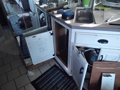

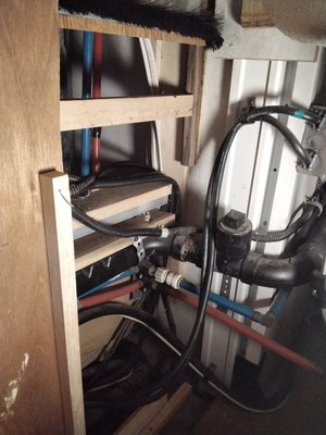

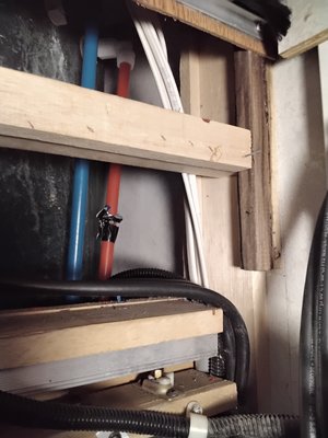

I found the access. Its at the rear part of the slide. I took the cupboard apart below the sink. I had to cut a access hole above the one they have there. Its tight, I will post pics. Image.jpgImage (1).jpgImage (3).jpgImage (2).jpg

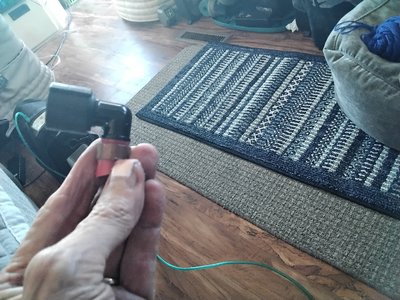

I also had to replace hot water 90 degree fitting.
No need to take out walls and shower. It took me 2 days, but I'm 71 and on oxygen 24/7.
Very tight quarters, if I was 10 years younger it would've been easier. The darn repair shop who I depend on couldn't find it. Over 25 years in the business?
