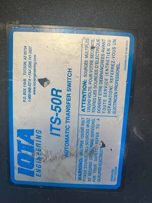

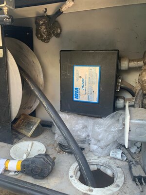

I need help locating the power control switch. My problem is everything works when generator is running but when I switch to shore power ac wont run and inverter kicks out.
There should be transfer switch located close to your shore power cable
Thats what I would think . whats it look like? does it say transfer switch? Just asking for a clue.
Not sure what brand transfer switch you might have. If you trace the power cord it should lead you to it
I have a 2006 Holiday Rambler so it should be VERY similar to your coach. Mine is in the rear compartment where the power cord is. Mine is a grey box and it even says transfer switch on it. See attached pics. Hope this helps!
