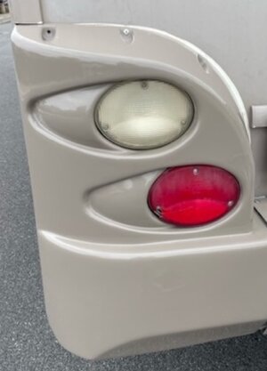

I have searched and cannot find the rear tail light clear reverse lens replacements. I heard there may be a source in the UK. Do RV salvage/junk yards exist for these rigs? I know most parts are interchangeable but some aren't. Thanks in advance.

Look for a DOT number on the lens and post a pic of it. @Neal can tell you how to identify it.
Thanks. I will get the DOT number tomorrow. This is a reference pic of the lens needed.

I had the same dilemma with my 92 Pace Arrow . I needed a tail light lense I looked to every Motorhome parts outlets I could find . They were scarce and expensive as all get out.
After looking at the small print on the old lense to my surprise I found Ford part numbers and DOT numbers. Come to find out the lenses were from a 89-93 Fox body Mustang .
Went on line put in Fox Body Mustang and found hundreds of them . I paid less than $100.00 for two R and L .
My headlights are from a 1990 Ford F-250 . Bought them as well . So look at the small numbers on the lense. ☝
My headlight assemblies are Dodge Nitro (whatever that is), my tailights are ’07 - ‘09 Dodge Ram.
The Dodge Nitro was essentially the Jeep Liberty with the Dodge badge.
