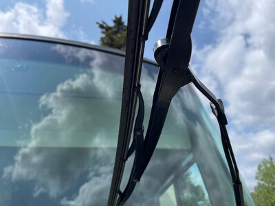

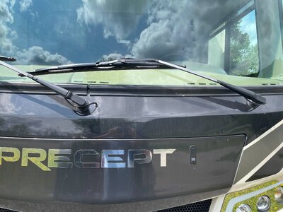

Photos of our 2019 Wipers. Clearly J Hook style. I suspect they would be the same as yours.

Thank you for the response. Do your blades snap in or securely connect in any way? Mine don't seem to be securely attached.
A photo of yours would probably help us to diagnose your issue.
