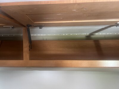

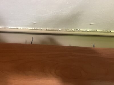

Over nine years of never ending problems with the build quality of this coach. I could write 25 or more major problems that we have worked through, here is a few big ones.
Main slide struggles to move, two replacements, problem; dinette screw ran through the floor forcing the steel roller plate down and binding.
Kitchen counter and drawers flexing abnormally; found that there was no structure on the entire span in the back side of the cabinets supporting it to the floor.
Microwave fell out of it’s mounting position; found one side of the main front bracket with three screws, spanning a 1-1/2 inch airspace and possibly grabbing two threads each when it finally hit wood.
Overhead dash cabinet pulled loose of its mount from the bottom of the bunkbed; just found so haven’t figured out how to fix this yet.
