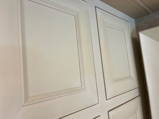

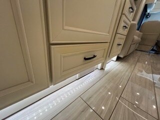

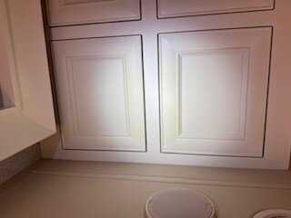

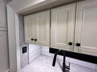

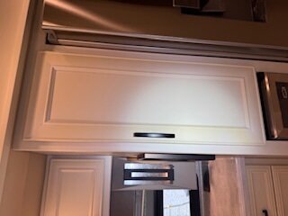

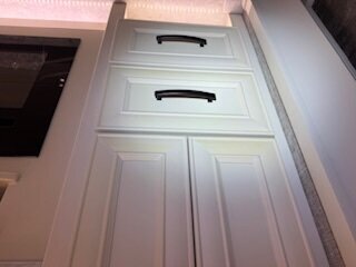

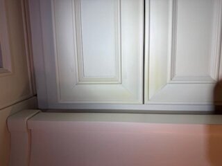

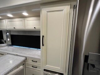

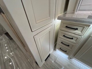

Has anyone had issues with Tiffin 2023 (or around that year) Linen colored cabinets yellowing? We just got an inspection on a 2023 Allegro Bus 45OPP and these pictures were taken. It only has 6000K miles and was stored indoors so it can't be sun damaged. We think it's a defect with the paint. Apparently Tiffin will only warranty these for the original owner. We may not purchase due to the discoloring. Any advice or has this happened to anyone else?

If that's the only thing causing you to hesitate maybe make them an offer which includes your cost for refinishing all the cabinet work.
We are discussing that option now. The only problem is I have no idea what a fair reduction in price would be. I think eventually they would all be yellowing. Maybe $10k? There’s a lot of cabinets in there!
ask Tiffin to give a quote to refinish them
Yes, all would need to be refinished. The doors will need to come off, everything primed and then painted. Most any reputable interior painter could do it. As for cost, I'd ask around first.
Update on the yellowing cabinets: The current owner contacted Tiffin and they were aware of the yellowing issue on some of there cabinets. Apparently there was a problem with the topcoat. They were actually repairing one at Red Bay when the current owner called about this one. He's taking it in next week and they are supposed to take care of it. I hope they reface all of them so they will match since it's only a 2023 bus. We're so glad we hadn't transferred the title to our name yet!
