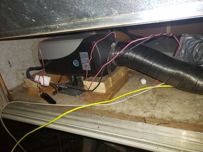

- 8kw diesel heater with exterior 1.1gal aluminum fuel tank, interior air recirculating and controlls

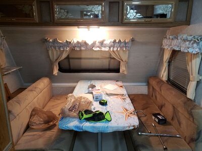

Newish jacknife couch, wood trim needs painting

Diesel heater in passenger stow w exhaust cutouts. need finished pics and fuel pump and exhaust (-15lbs, 55 including dry propane tanks and diesel tank)

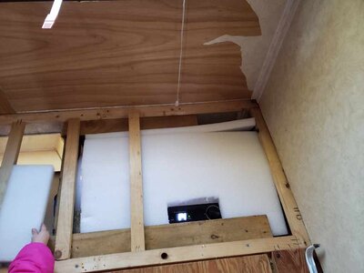

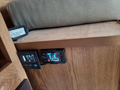

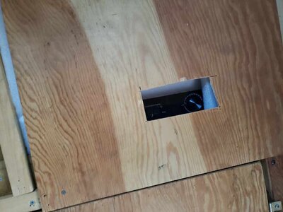

The winter solstice doesn't leave much spare power for power tools and powering a project house but here's my progress pics so far:

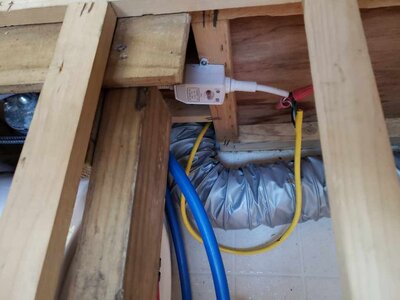

Heater insulated with help, window to control and LCD cut through bed frame, GFCI tied to inverter supply

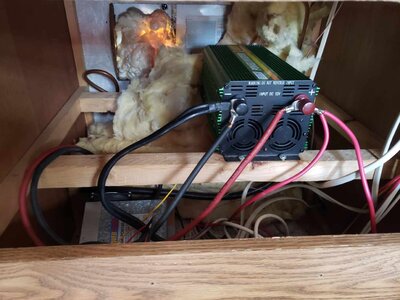

2.8kva inverter for water heater and backup mains supply, 2.8kva Lifepo4 bank

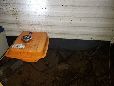

1.1gal diesel tank for heater 3.9kva AGM bank to the left

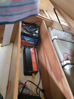

3kva mains inverter, the solar conduit will run through the old furnace exhaust now filled with foam to the left
Diesel heater and mains inverter control panel temporary position. Will replace furnace thermostat cut in

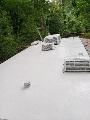

Caravan roof recoat before edging and panel supports... From a warmer time a few months ago.
