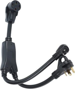

There are also adapters on the market with two plugs that allow you to plug in to both a 30amp and 20amp outlets at the same time, the theory being that you now have 50amps available. I bought one and it just tripped the breaker so from my personal experience, they don’t work. I really didn’t think it would but bought one to find out.
This is the one I tested, sold on Amazon by Blackhorse Racing, that did not work:
