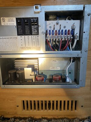

Thanks for the bounce back, there are two, 30 amp fuses that i understand are from the converter that are above the row of smaller fuses for the appliances,. I removed the cover and found the converter below the fuse panel mounted in back of what looks like a 1920's ham radio. coils of copper wire, etc. Not sure what this is but the silver box in the back is the converter. I pulled the model number from its tag. coming from the converter are a black and white wire running up to the 30 amp fuses. I disconnected these two wires to isolate the converter and when 12V applied the fuses still pop. I will be digging into the panel further to trace wires, do you know of a good electrical diagram ? I am having a hard time finding anything helpful so, I am doing this blind at present, looking for obvious issues, as I thought it was the converter. No brakes, More to follow.....
This does not sound typical. You might want to look it over, using a mirror for the back side, to see if there's any info on it. Also, see where, exactly, the wires to this unusual contraption go.

Any way you can post a pic or two, especially of this magic "black box" that may not belong there?

OK, Think I'm on it, after properly tracing the "Blue" wire and white wire from the converter, see photo how I was deceived by the black & white wire coming from the lower unit. Once wires from converter were disconnected the fuse stopped blowing, back to shopping for a converter.
Thanks for all the feedback and help, and let me know what the lower unit is, amplifier ? maybe ??

Did a bit of searching for that "series 7300" and "model 7345" info on that sticker. Came up with a bunch of pics, and it appears that the "extra" little device is actually a sub-section of the convertor as a whole. That will probably come out of there when you pull it in favor of the replacement convertor.

Thaks again for the help, sooooo... I am assuming that the replacement (upgraded) converters that I am seeing on amazon should replace everything on the shelf ?? Interesting .... I am only seeing one available that says it replaces the 7345 converter, guess I will get one of those ??
