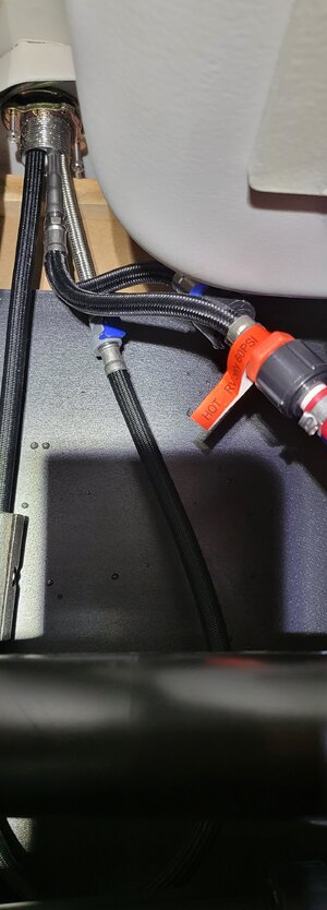

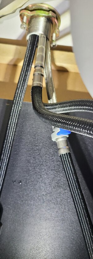

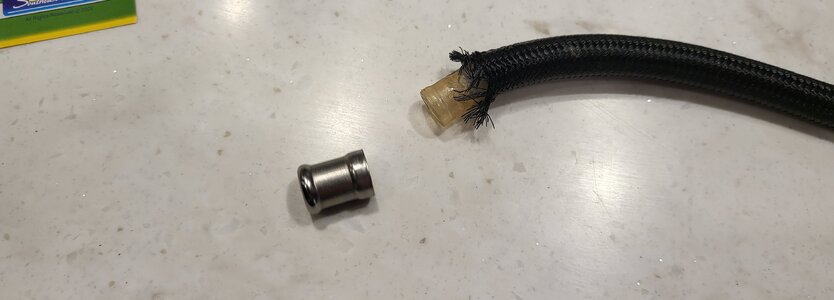

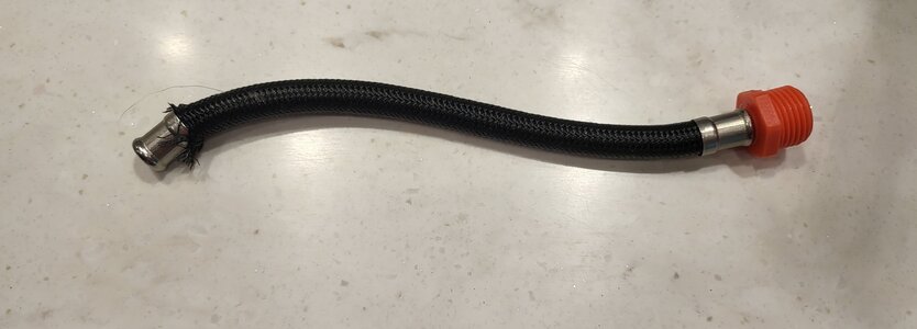

This just happened to me! Luckily I was there when it happened and heard the rush of the water. I turn off the water supply in a hurry and quickly dried it up. Thank you for this post, you saved me from a hugeheadache. Headed to the hardware store to grab the stainless steel supply lines. I may as well change them all as this could have been a total catastrophe. Amazing that a $10 part can ruin a 100k Rv!
