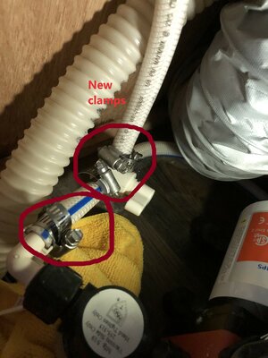

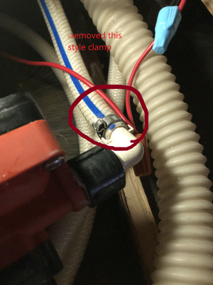

On the section line where the diverter valve and swivel elbow connect to hose, found that hose would spin on fittings. The clamps on these connections are the crimp type, going to change them to radiator hose clamp type.
Don't like radiator hose clamps, but not much choice here as the stainless ring clamps don't seem to crimp hard enough. The hose is 2 pieces and larger in diameter then the barb. Just a poor material they use because it bends in curves.
If you were winterized and air was blown into the system, it could take a while to get the air out. I have a large hot water tank and I will not get anything for a while, then spit and sputter.
Fixed! Put on new clamps. Also removed inlet filter. with the new pump installed no more air. Pump worked as advertised. Decided to remove new pump and install old pump without inlet filter. Same results, no air and pump worked fine. Installed inlet filter, tried again air in lines and pump wont shut off, it slows down put keeps on running. removed filter again and all is fine. Just ordered new filter. Can't see any cracks in filter housing or bowl, seal looks good, but must have something wrong with it. Thanks for all suggestions

The stainless band clamps are OK, in their place. Their place is on the exact hose and fitting combination THAT clamp was designed for. They are not universal for just any size line. The clamp was designed to only squeeze so far, once you need more squeeze than that you need a different clamp.
