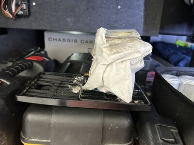

Now that we have a comfortable space to do maintenance of RV, I have been wandering around checking off items of concern.

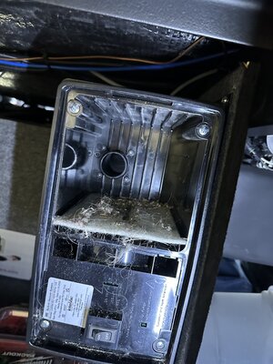

Vacuum filter, not installed correctly at factory!
Front hood rubbing on paint. Extended bumpers so hood no longer touches painted surface when latched.
Etc.
Yes, replaced the bag with new bag from Amazon. Always something to find when poking around the RV...
I’ve found that I need to trip a bit off the cardboard at the bottom of the filter to get it to fit properly.
On ours I cut 3/8 inch off and it fits much better without leaking around the gaskets.
We just installed “upside down” according to the markings. Fits fine?!
