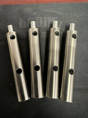

Hello, I have a quick question. After fixing one of the atwood levelegs system leg 4 times already, I got tired and I'm looking for a replacement without any luck. It's always the driver side front leg that breaks the pin and stays down. My question is are the lippert electric leg system compatible with the atwood levelegs? I see that they are very similar. The atwood leveleg model is 66280 7.5k 15" I'm looking at a Lippert leveling leg that looks very similar.
Atwood leveling Jack if you are looking to repair the pin inside your leveling jack I have the solution I have some extra sets of pins to repair the mechanism of your the jack Iran in to this problem few months ago and found a place that made me few sets of pins nd that way I can go anywhere with my RV 2007 Tiffin Phaeton without worry always caring with me a set of pins in case the brake in pieces
Where did you have them made? I would like to get a set
I have reverse engineered most of the trouble parts in the atwood systems and can provide parts and support.
