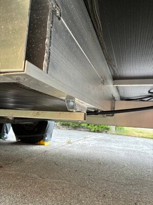

Aucta Willow support rail detached

Noticed this rail hanging by virtue of the propane gas line. Second Photo shows the front end of the rail, the self tapping screw was never set to pull the rail flush with the cross frame support. There should have been a 1” spacer at the front end. I think this lack of spacer allowed the rail to vibrate and pulled out the next screw, first photo.
