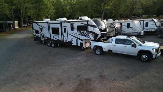

I am not looking to replace my spare tire with a tank, I am looking to add one to my truck bed.
I want to put a cover bed, so the tank needs to be less than 21-inch height and ideally have toolbox
I am looking at 90 gallons models.
I am planning to drive ~ 10-12k miles a year, so pay-off time for 2k tank and diesel savings will be pretty much 3-4 years.
I already signed up to open roads fuel-saving card.
I have a standard 8 ft truck bed with a goose neck, so I have plenty of space.

Yes I will be adding close to 700 lbs to my truck. My payload capacity little more than 5000lbs and my tongue weight ~3200, so i still have some room. meaning it is doable with my set up. I am not 100 % sure if is essential, that is why i am asking this question to see all pros and cons for my "wants" :)
