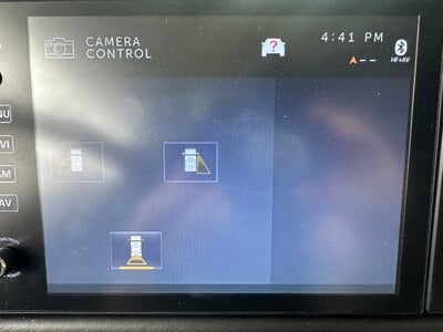

Has anyone ever had an issue with the backup camera
My side cameras work but not my rear. I also have a flashing question mark in a car on the screen
Any help?

My guess would be it's not seeing the rear camera connection.
There may be a hatch on the rear cover that gives you access. Up top that is.
The controller for all of the cameras may be a box under the dash. It will have a wire goin in for each camera. Try swapping wires to determine if it is the camera or something else.

Yes, I had this problem last year. Went to my local rv repairman. He substituted a camera he had in stock and it worked. So we had to order a new rear view camera. Works fine since then.
