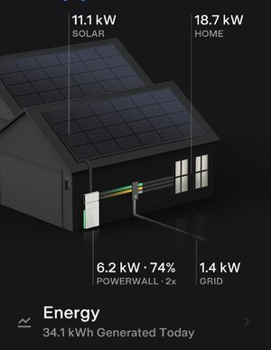

My home system is 12.5kW of panels with two inverters. However when installed only one inverter was active due to the Grid operator limiting production until permit’s approved.
limit 7.6kW.
Ok once I got the permit I turned on the other inverter. Max production 8.6kW????
After many months of fusing with the installation I discovered that a) installation is designed to run inverters at max capacity b) panels were not wired per spec.
too many panels driving one inverter.
Inverter production is limited to X Watts.
Inverter one limited to 7.7kW and inverter two limited to 3.4kW.
Once the panel strings are correctly wired each solar panel group is able to max its inverter at mid day.
Production 11,1kW at peak.
