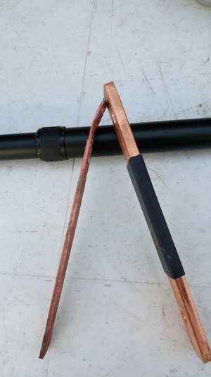

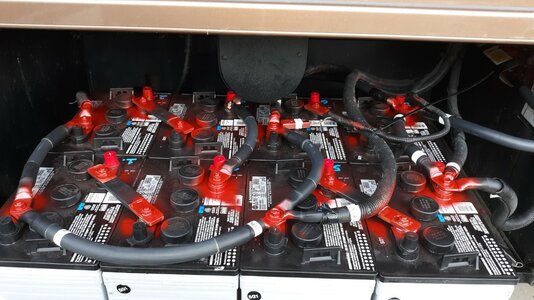

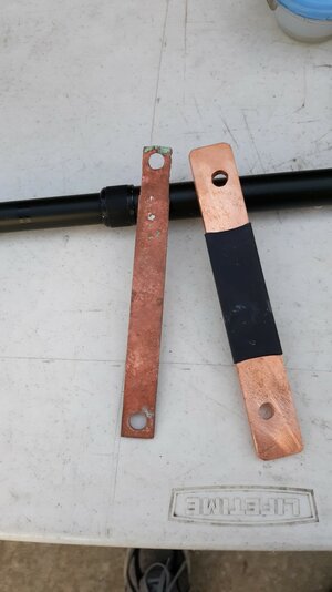

I changed to AGMs. For me, the biggest advantage is not having to add distilled water every month and all the corrosion from off gassing. Also replaced the battery cables and copper connecting bars. I bought mine at O'Reilly. Had one fail after 14 months. We rarely boon dock.
Finally found the pics I was looking for. The copper bus bars on the batteries do corrode a lot more than I thought. As you can see, I replaced them with thicker bars.
I hope not with the AGMs!
I am partial to using welding cable. Most of the time I use copper tubing for bus bars because it offers more surface area than solid bar does.
