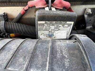

New house batteries, but the engine won't charge them, nor will the generator.
The inverter seems to work as I can get 110 without being plugged in or the generator running.
I suspect the separator? As I search, I see articles about an isolator, but which is best? Easy to install?
You may want to get a meter and check for voltage on both side when the rig is running. Also track the wiring for damage.
