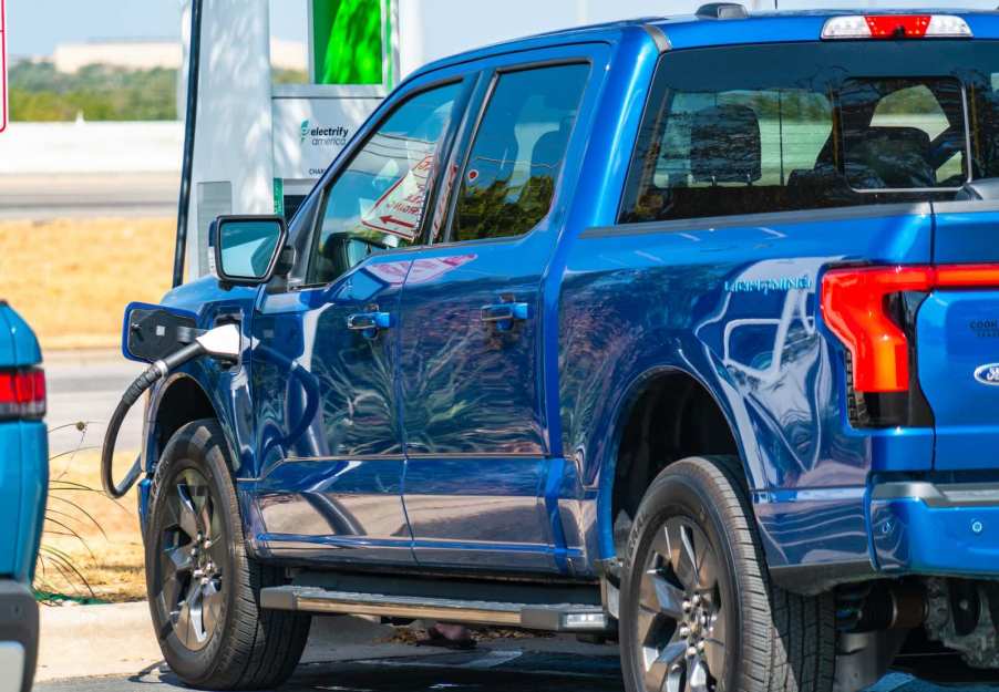

Ford F-150 Lightning EV pickup truck charging.
