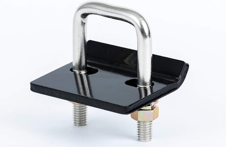

Just get a hitch tightener and you wont have to worry about the rack moving around. You are also much less likely to get rack rash on your bikes because they wont be moving around as much. I used parts and pieces from a couple less expensive racks to build a custom rack that fit my two Specialized Teros, both over 60lbs, and its working out just fine. If you’re worried about metal fatigue, just inspect it every time you mount it. I agree you don’t want your rack bouncing around, but I think all that concern is more CYA on the rack company’s part than anything, but I guess its probably happened.
About $10 from Amazon
Not applicable. All racks I've looked at have built in hitch immobilizers.

I bought a Thule Easy Fold XT 2. It was one of a very few that were rated to carry our two e bikes on our toad (Jeep JK). The carrier works great but hitch tensor (the part you tighten to make sure there is no wobble) was junk. I almost lost our bikes twice because the threads on the tensioner bolt stripped. The bolt was replaced once under warrantee (the dealer said it is a common problem). After the second failure I took the rack to a Machine Shop and had the receiver modified. They welded on a proper two inch tube and I added a hitch tightener (as suggested by Rich W) and now have worry free travel. Be weary of the factory Hitch Immobilizers.
