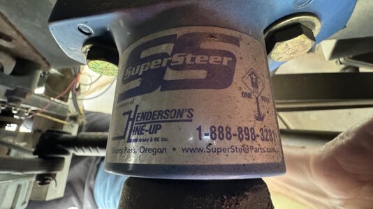

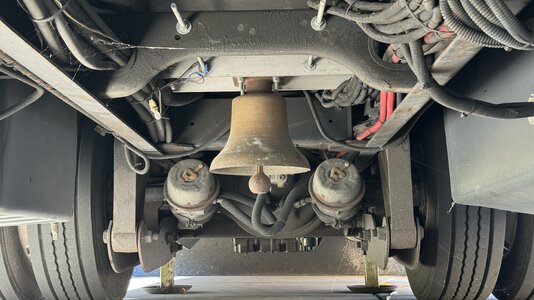

Not that I'm suggesting you poor money into the front end...I will mention that Henderson products Super Steer are great additions. I have their bell crank replacement as well as the Trim Unit with the Safe-T-Plus and have replaced the front sway bar bushings with their replacements. The shocks were replaced with KONI's. They are wonderful shocks. Had Bilstein and they were a failure (long story). I LOVE the trim unit...and have had techs from the alignment shop praise the drivability of the coach when they compare to others. Again...good luck with your quest.
Thank you Rich. I'll take a look at Henderson. I don't know what some of these devices are, bell crank, trim unit, but I'm gonna check it out. All this information, it's so valuable because it has your stamp of approval. Or Bilstein, your disapproval. Valuable stuff.

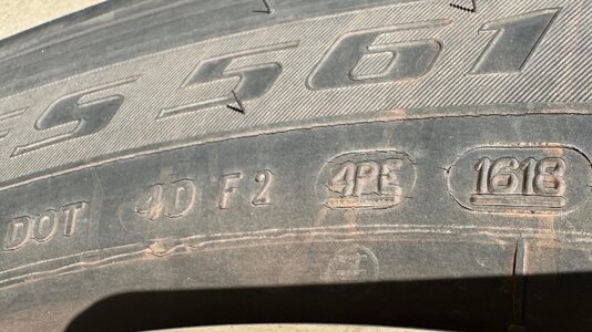

They're a little dirty from our trip to Tahoe, but they clean up nice. They have lots of tread, very minor sidewall cracks, and as I mentioned our trip on highway 20 was brutal. Our trip to Tahoe last month we took the back way winding thru highway 88 to Minden NV and then highway 207 over the Kingsbury Grade into Tahoe. Take a look at these roads on a map. If these tires were going to fail, I've already given them plenty of reason to do so. I have a friend bringing me a set of Alcoa wheels for this rig hopefully before the end of the year, possibly with tires on them. The guy at Freightliner saw the date and said he wouldn't drive it to the next red light. That was about two years ago, and Oregon, Utah, LA, Bodega Bay, San Diego, etc. Because of this post (Can't Look Away) I took some pictures of the tires to look up specifications. So here ya go.

In reference to your picture of the tire...I would not keep those. They do have lots of dry rot and cracking. I am hopeful that I do not read about a crash from a blowout. Also...you are misreading the date code. And it is the 16th week of 2018.
I agree about the dry rot. The age of the tire indicates it’s time to replace and the dry rot confirms it.
These tires go from “minor” looking dry rot to large strips of litter on the highway very quickly.
With trailer tires and motorhome tires tread is often irrelevant as the tread usually looks good. It’s the sidewall that causes issues.
Background - I fall into the rare group that likes to keep tires longer than most and inspect both sides of all tires before each trip.
Based on your pics I would be replacing the tires as the cracking is more than minor.
