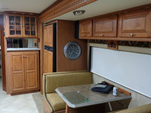

The time came, the wall clock needed its battery changed, I always wondered how/where. There are three screws holding it to the wall. Naturally a screw driver doesn't fit to get to the screws. Come to find out it's hanging from the top center of the back frame, the two side screws just hold it in place left/right. So you need to lift it up off the top screw then work it out from under the flanges of the cabinet screws, replace AA battery and remount.

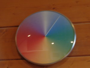

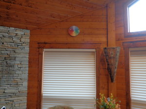

Our clock is held by a couple of velcro tabs and hung on a screw head. Once the velcro is released by a slight tug, the clock lifts off the screw head.
Same here. My Phaeton had a framed picture hanging on the wall, which I replaced with a clock. Hung it the exact same way as Joe's. Needed a clock much more than I needed a picture. :-)

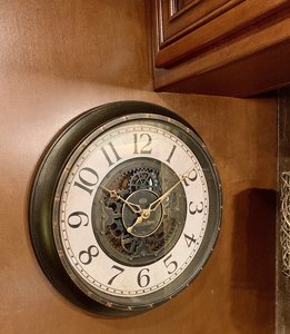

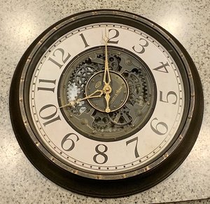

We just bought a very good looking clock from Walmart for $12 to replace the original one.
Picture please?
I knew this was coming NWIP. The coach is in storage mode, and the clock is not installed yet, but I tried my best. Here what it looks like. Just $12?
