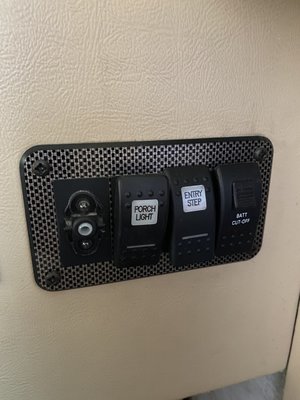

I am working on a 2005 Monaco class A motor coach. At the entry way is a four button array and one of the switches is broken and does not work. The owner states it is a battery cutoff switch but there is already a switch for that at the other side of the array. Any advice on where to find information as to what the switch is and where to get a replacement? Thanks in advance.

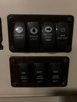

I have a 2006 Holiday Rambler Ambassador built by Monaco. Here is a picture of my entry switch panels. I think the switch that broke was the ceiling light switch. This would also be the switch that got the most use over the years. This is probably why it broke. I would think you should be able to find a replacement.

I'd LOVE to know where to purchase these switches and see if they are compatible with a 2002 Fleetwood Discovery. I need to replace a set of 4 at the front and these look so much better than what is currently there. :-)
Call these people. I have found several Holiday Rambler pieces there. These would also fit Fleetwood/Monaco up until about 2008.
If you haven't found a switch yet, take it out or take pictures of it and go to your local auto parts store. I know we have (NAPA) switches that look very similar to that.
Should be a on - off rocker switch with a light. Just be sure it fits your hole. NAPA # ECH RS1059
