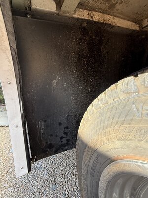

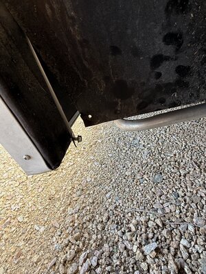

There is a metal shield in the left rear wheel well to protect the generator in front if the wheels from road debris. The attachment point developed a stress fracture and broke. I did a quick fix to stabilize it but I would like to get a replacement. Any suggestions on where to look?

Typical newbie mistake. Didn’t add photos. The small hole is one I drilled. I did a temporary fix by tying it down to the bolt with stainless steel wire. Again, this is a 16th inch thick piece of sheet metal that is in front of the driver’s side rear wheel to protect the generator which is just anterior to the wheel. It is held in place by the bolt. The stress fracture occurred by the bolt.
